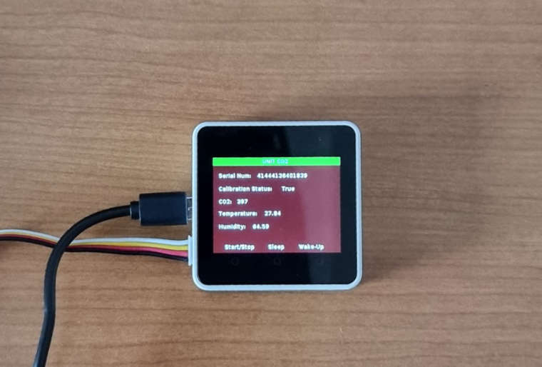

@mtylerjr Just tested the M5 demo example with my CO2 unit.. I don't have the L version, actually was not aware of its existence.
After a first run the sketch reported errors, the demo program uses Ubuntu font that does not exist on Core 2 UIFlow 1.12.3... I replaced all the labels fonts by default and yes the sensor works on Core 2

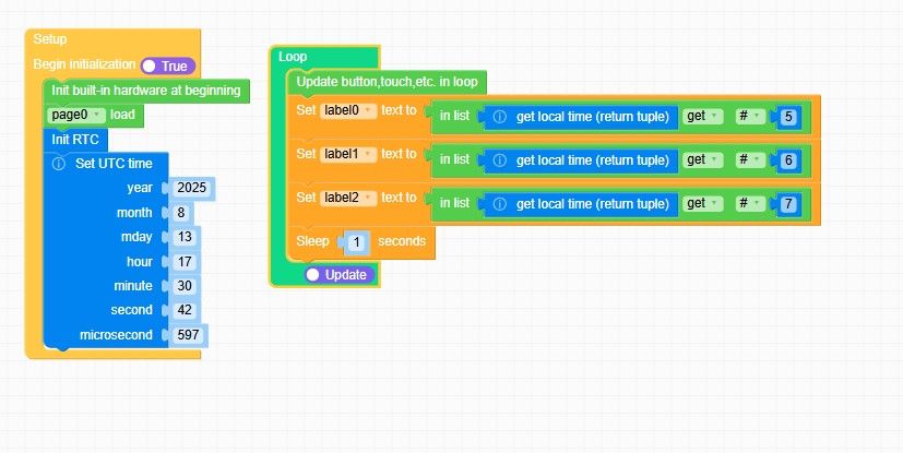

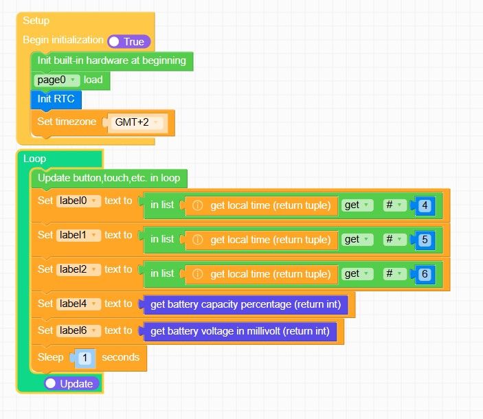

Finally I tried to not set the time and work with the Time section rather than the RTC section with the assumption that the device being connected to Internet anyway, it would get the correct time by itself.
The following example works flawlessly and closes my issue as a reference for fuuture developpers

I am using a Core S3 with UI Flow2 and having trouble with the RTC functions
While the year month and day information of the tuple are correct, the hour and minute are not
Hour is displayed as 0 instead of 17 and minutes are 17 instead of 31.
Seconds are correct.
I get the same results with a Core 2 under UI Flow2
Reverting to UI Flow 1 and Core 2, The information is correct.
As I examine the python code generated by the blocs, they appear correct to me.
