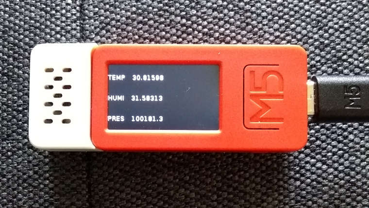

Why is the ENV3 reading is way off, I attached my thermostat and the ENV3 output.

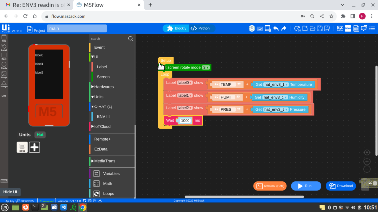

I was bitten badly using the Desktop IDE (had hard time connecting to flow.m5) not conscience of the missing HAT blocks in IDE, I just click on the '+' symbol under Unit on the left panel, picked ENV3 , went from there and got 'env3 unit maybe not connect' running the example blocks.

Resolved, the part that generated 'env3 unit maybe not connect' , I use the HAT (ENV) this time and don't get the error message. This, I still not sure that I blindly got it as I supposed to. Well, go on learning. Thanks.
