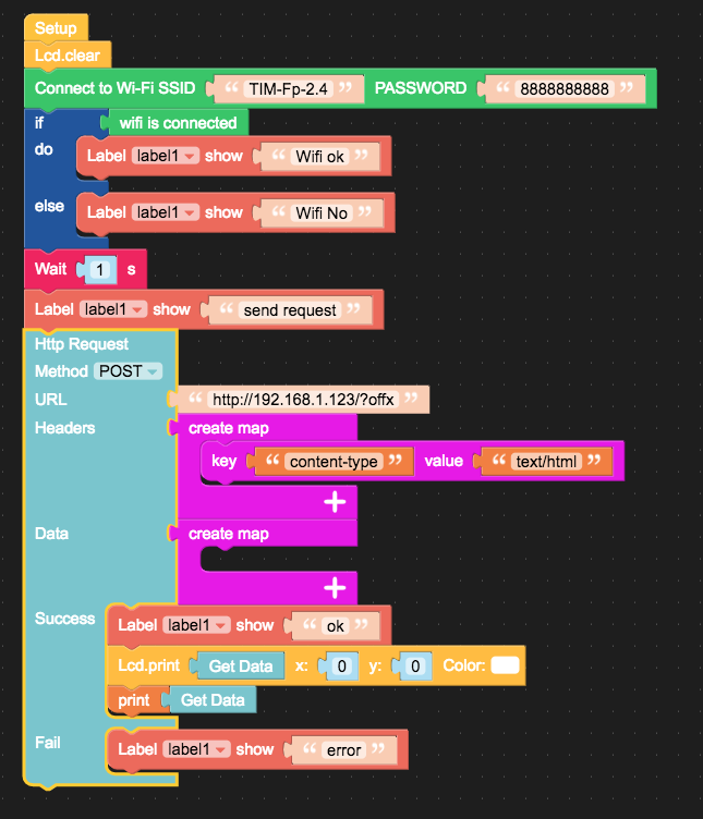

@world101 i use mac and the browser Safari give me a different error:
"Cancelled load from 'http:79.8.125.79:84/?onx' because it is using HTTP/0.9" (:0)HTTP/0.9 is the problem?

@world101 i use m5stick, last update, uiflow last update.

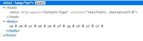

about the device, it is a hw that work as e web server, to comunicate to it you send a Httppost http://ip.../ the command, as it receive the command it respond.Try yourself use a browser:
it respond:

ua 1 ub 1 uc 1 ud 1 ue 1 uf 1 ug 1 uh 1 ui 1 ul 1
</body>
</html>

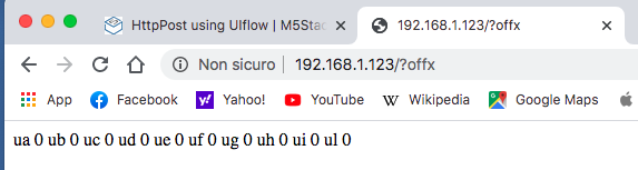

try
http://79.8.125.79:8084/?offxit respond:
<html lang="en">
<head>
<meta http-equiv="Content-Type" content="text/html; charset=utf-8"/>
</head>
<body>
ua 0 ub 0 uc 0 ud 0 ue 0 uf 0 ug 0 uh 0 ui 0 ul 0
</body>
</html>
In the body i get the Port ua 1 or 0, etc etc
i tested using esp32 and arduino.app and it work.
I don't understand how to use UiFlow standard command. i like it and i understood most of the sintax but in this case i don't.
it look simple but it doen't work. -

HTTPPOST problem
why if i use the browser and this path "http://192.168.1.123/?offx" it work (it is a IOT device), if i use the following program it those not work?

Tested, and it doesn't work, no response and it doesn't send the command.I tested using the browser and i get the response and the hardware does what it have to do.

i use a browser and i give this Url :
"http://79.8.125.79:8084/?onx"
and then i get:
<html>
<head>
</head>
<body>
</body>
