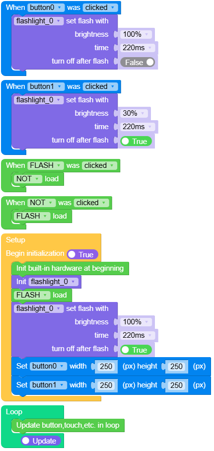

Got the Tab5 last week and been doing different Uiflow2.0 sensors and Lights etc. Just playing with it.
Problem is that all of the Programs with just sensors and no buttons work great. Can reset back to menu and load from device. Anything with buttons locks up the Tab5 after loaded and configured from M5Burner after download. Core2 and Core3 all run find with the updated firmware. Any ideas??? -
