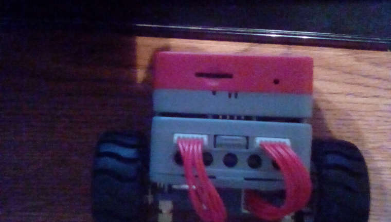

I notice that when I put the M5Stack Fire on top of the balance car base, I can see a substantial gap. Is that supposed to be that way? (see picture). Also, I have the same problem with the charging cable with pogo pins on it. The charging cable does not stay connected. Seems like the pogo pins are stronger than the magnets. Is there some trick to using that charging cable?!

The documentation on this M5Stack Balance car is terrible. I tried the quickstart directions (turn on M5Stack Fire then turn on base). The Fire powers up, but the base does not. There is supposed to be green LEDs lighting up on the bottom? I don't see anything written where you even have to charge the battery in the base! Do you charge it by itself? Do you charge it with the Fire on top of it? How do you know it's charging?
I assume you can charge the battery in the base by itself. So I plugged it into a USB supply. There is a sold red LED light on the right. The left LED (I think that might be an LED) is off. Since the right LED is solid and not blinking, does that mean the battery is fully charged? Can you power the base by itself (without the Fire on top)? When I press the base power button, nothing happens. Can you power the base on while it is charging? I do feel the top of the base getting very warm as I have it plugged in.
