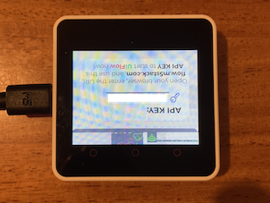

RE: UIFlow doesn't start on new Core2
After struggling for a while, I had this Core2 replaced at the shop where I bought it as an initial defect.
I'm not sure, but it seems that the display mechanism in Arduino and the display mechanism in UIFlow are different, and even if Factory Test works normally, it may not work properly in UIFlow. -

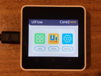

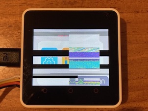

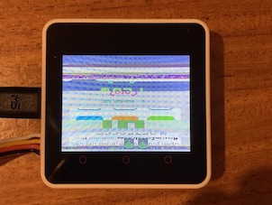

It seems that it was a short-lived joy. Revert to a black screen, distorted screen, or an upside-down screen.
I tried v1.7.1.1, v1.7.1, v1.7.0, v1.6.6 and they are all the same and have a black screen.
It's HW problem?
Also, even in this situation with UIFlow is running, if I burn factory test firmware, it will work normally.
I don't know what happened. Core2 that has not been displayed with UIFlow for 2 days since I bought it, suddenly, yes suddenly, when I reset Core2, something was displayed, and every time I reset it, the display was distorted or displayed upside down. After several resets, the display is now showing normally.
I feel that there is an unstable part in the display-related HW. Firmware is UIFlow_Core2-v1.7.1.1-core2.bin.

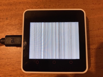

Since UIFlow display nothing on the screen, I tried the test with the ILI9341 library for MicroPython I found.
https://github.com/tuupola/micropython-ili934x/blob/master/ili934x.pyI copied the above library to Core2 and ran the following code from the serial console.
import ili934x from machine import Pin, SPI spi = SPI(miso=Pin(38), mosi=Pin(23, Pin.OUT), sck=Pin(18, Pin.OUT)) display = ili934x.ILI9341(spi, cs=Pin(5), dc=Pin(15), rst=Pin(4)) display.fill(ili934x.color565(0xff, 0x11, 0x22)) display.pixel(120, 160, 0) display.print('1234567890 ABCDEFGHIJKLMNOPQRSTUVWXYZ') : : : display.print('1234567890 ABCDEFGHIJKLMNOPQRSTUVWXYZ')As a result, the characters are displayed as shown in the image below.
I'm not sure what this means, but can it help analyze the problem?

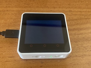

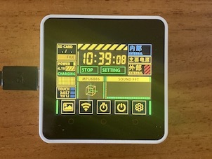

It seems to be the same situation as the Core 2 I bought yesterday.
Core2FactoryTest and draw_by_touch work fine, but UIFlow_Core2 v1.7.1.1-core2 (I also tried v1.7.0 / v1.7.1) doesn't work.However, it seems running with black screen. I tried connect to Core2 from UIFlow Cloud and run the program. print() can print text to the serial console, but M5Label will show nothing on the Core2 screen. just black screen.
I tried burn with low baudrate (115200), but nothing changed
