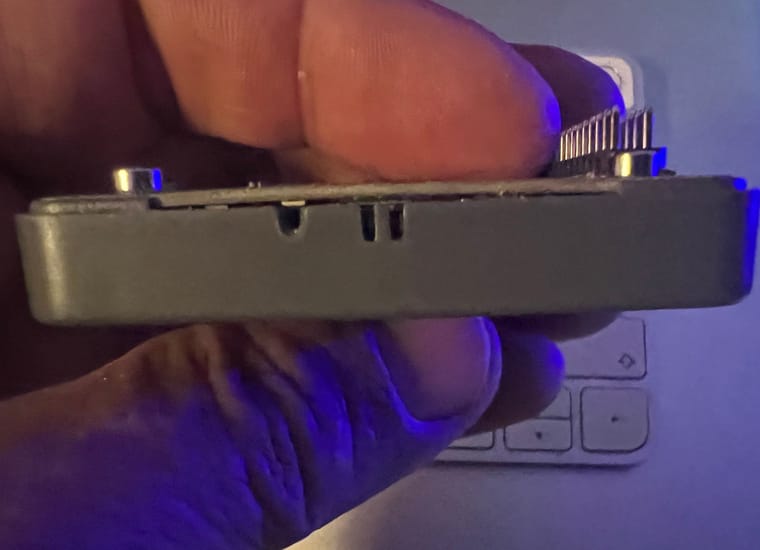

RE: Battery Bottom2 does not charge from M5GO/FIRE Battery Bottom Charging Base
@ioamas
Does anybody knows how to check if the M5core2 is connected to the bottom2 base power with a code? -
@teastain
thank you for your answer and concern.
I did open the bottom by removing the circuits screws.
The problem was that on of battery wires was caught between the board and the plastic and was creating the problem. everything now ok!
Thanks everybody for the help -
@felmue
you gave me an idea.
I opened it and checked the contacts- on the inside of the bottom2 - they do not contact the pins of the base. also the board seems elevated in this area. I guess something did not go well in assembling.
Thank you
ioannis -
@felmue
I have done all that. power is ok on the pins and they are new, just bought them so I guess contact is good. -
@ajb2k3
neither red or green LED light up and also I wrote a small routine to check just to make sure.
It is definitely not charging! -
Hello
I am having this problem that the bottom2 battery does not charge from the base. It would charge from the top port on the M5core2 but not from the charging base. Even the charging led does not light when the usb C cable is inserted at the base.
I tried opening a query with M5stack site but they only replied once to check the led and then nothing.
Please help!
Thank you
ioannis -
