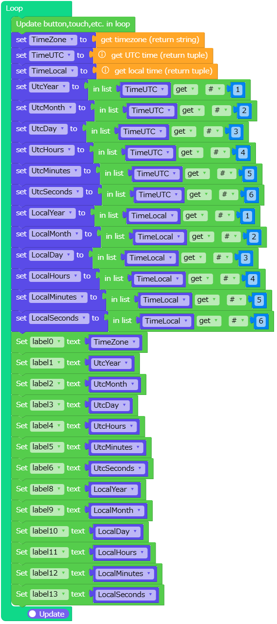

ããã«ã¡ã¯ã
UIFlow2ã®System-Timeã§ãget local time (return tuple)ã®æé(Hours)ã®å€ãæ£ããååŸã§ããªãããã§ãã
ããããget UTC time(return tuple)ã¯æ£ããååŸã§ããŠããããã§ããç°å¢ UIFlow2 V.2.1.4
æ©çš® M5Stack Core S3 SEãŸãã¯ãããã°ã©ã ãå®è¡ããM5Stack Core S3 SEã®ç»é¢ã®åçãæ¬¡ã«ããŸããŸãã
ç»é¢ã®äžã®æ¹ã«è¡šç€ºãããŠãããGMT+9ãã¯get timezoneã§ååŸããå€ã§ãã
ç»é¢ã®äžã®æ¹ã«è¡šç€ºãããŠããæéã¯ãããããget UTC time(return tuple)ãšãget local time (return tuple)ã§ååŸããå€ã§ãã
UTCã12æãªã®ã§ãGMT+9ã®Localã¯21æã§ããã3æãšè¡šç€ºãããŠããŸãã
ãããèšå ¥ããŠãçŸåšã¯ãåçãããæéãé²ãã§ãUTCã13æã«ãªããŸããã®ã§ãLocalã¯22æã®ã¯ãã§ããã4æãšè¡šç€ºãããŠããŸãããã®ãšãã®ããã°ã©ã ã¯æ¬¡ã®éãã§ãåè¿°ã®ç»é¢ã®ãšãããUTCãšLocalã®æ¥ä»ãšæéã䞊ã¹ãŠè¡šç€ºãããã®ã§ãã
æ¥æ¬ã®Timezoneã§ããGMT+9ã«èšå®ããå ŽåãLocalã¯UTCã«9ãå ç®ããæéã«ãªã£ãŠã»ããã®ã§ããã9ãæžç®ããæéã衚瀺ãããŠããããã§ãã
䌌ããããªç¶æ³ã®æ¹ãã解決çããæã¡ã®æ¹ãããã£ããããŸããããæç€ºããã ããããã©ãããããããé¡ãããããŸãã

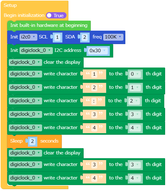

Digi-Clockãæã£ãŠããªãã®ã§ãããèå³ããã£ãã®ã§ãããå¯èœã§ããã°éã«ãæç€ºããã ãããæçš¿ããŠããŸãããããæ¬¡ã®ç»åã®ãããªãããŒãå®è¡ããããã©ã®ãããªåäœã«ãªãã§ããããã
å ¬åŒããã¥ã¡ã³ããDigi-Clockã
https://docs.m5stack.com/ja/unit/digi_clock
ã«æžãããŠãããI2Cã¬ãžã¹ã¿è¡šããèŠããšã12:34衚瀺ã®2ç§åŸã«34ãšã ã衚瀺ãããã®ã§ã¯ãªãããšæãã®ã§ããã
ãããè¿·æã§ãªããã°ãæç€ºããã ãããšããããã§ãã
