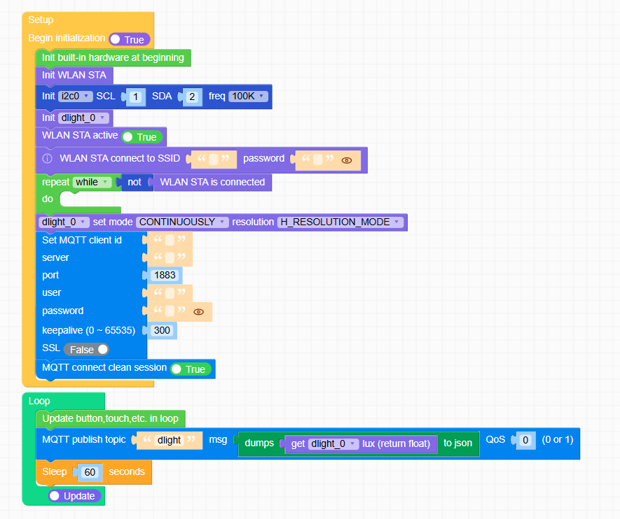

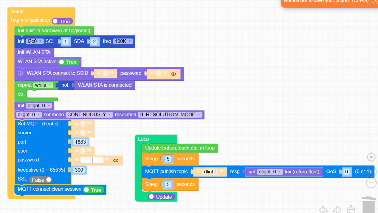

RE: Atoms3 lite with Dlight Unit to MQTT_ Not working
Thank you felmue for your assistance.
I have managed to get this working and the light readings are now passing through MQTT to my HA.I added the "dump (reading from the dlight unit) to json block" and all is working now.

Well this has been one of those projects where I have spent hours and got nowhere.
Can anyone tell me why this UIFlow2 program is not working. By not working I mean I am getting no messages (light readings) published to my Home Assistant EMQT server.

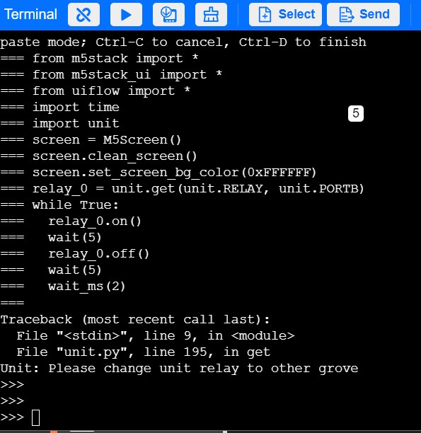

This is the simple program
This is the terminal response.
Does this indicate a problem with the Relay Unit programming in UIFlow? -

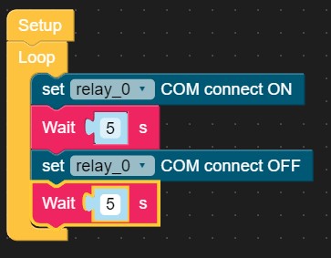

Stupid question! I have been trying to get my relay units working on UIFLow 2 with an AtomS3Lite and on UIFLow 1 with a Stamp Pico. I've resorted to very basic programming to turn the relay unit on and off once every 5 seconds and they are not working. I have used these M5stack relay units only last week and they were both working fine.
I'm just wondering if something is broken in both versions of UIFLow?? -
