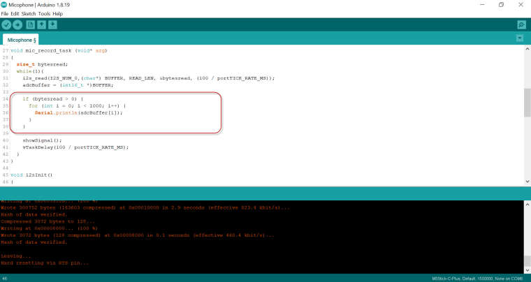

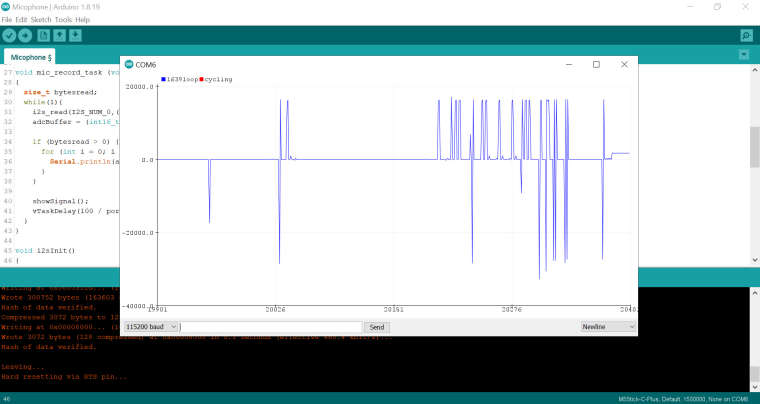

Thank you Felix & ajb2k3! I tried to run it using the above changes and the example runs so well on M5stickc Plus. Is it possible to print the values using the Arduino IDE's serial plotter? I tried it like this, but it is not a clean wave ....!! There seems to be an offset in the signal? Thank you so much for saving the day!

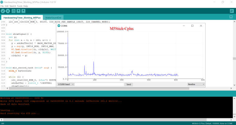

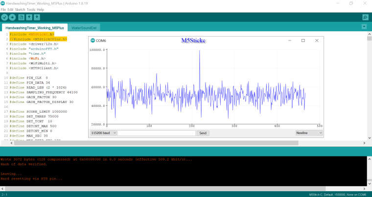

Hi all, I tried this sample using both M5stickc and M5stickcplus devices. : Hand washing timer with water sound detector. Both devices work fine. But noticed that the M5stickc is much more superior in terms of microphone sensitivity. Same exact code. Only changed include files: #include <M5StickC.h> or #include <M5StickCPlus.h>. Take a look at the graphs of sensitivity (predictions) from both the devices in the same exact place/environment. Disappointed since M5Stickc is in a EOL status :(. If anyone has any thoughts please share. Thanks.

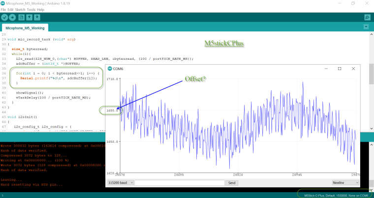

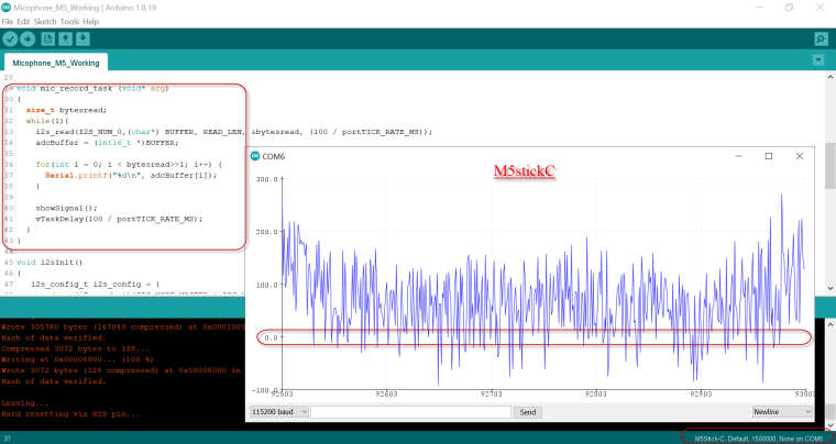

M5StickC PLUS microphone buffer value has an offset when compared to M5StickC
Hello. I have tried the basic microphone example for M5stickc. They work well and shows on the tft screen. I wanted to print the same wave form using the Arduino serial plotter. Wrote this code to print buffer values.
------------ code ---------------
for(int i = 0; i < bytesread>>1; i++) {
Serial.printf("%d\n", adcBuffer[i]);
I observed that M5StickCPlus values behave differently. Same exact basic microphone code. Only difference is the include file (#include <M5StickC.h> or #include <M5StickCPlus.h>) Between M5stickc and M5stickcplus, I think there is an offset in cplus of a constant of approximately 1650. I am not sure why or if this is normal in cplus stick and if this will affect accuracy in terms of using it to detect a particular pattern of sound waves using FFT or TinyML etc.? Thanks for looking into this issue.
