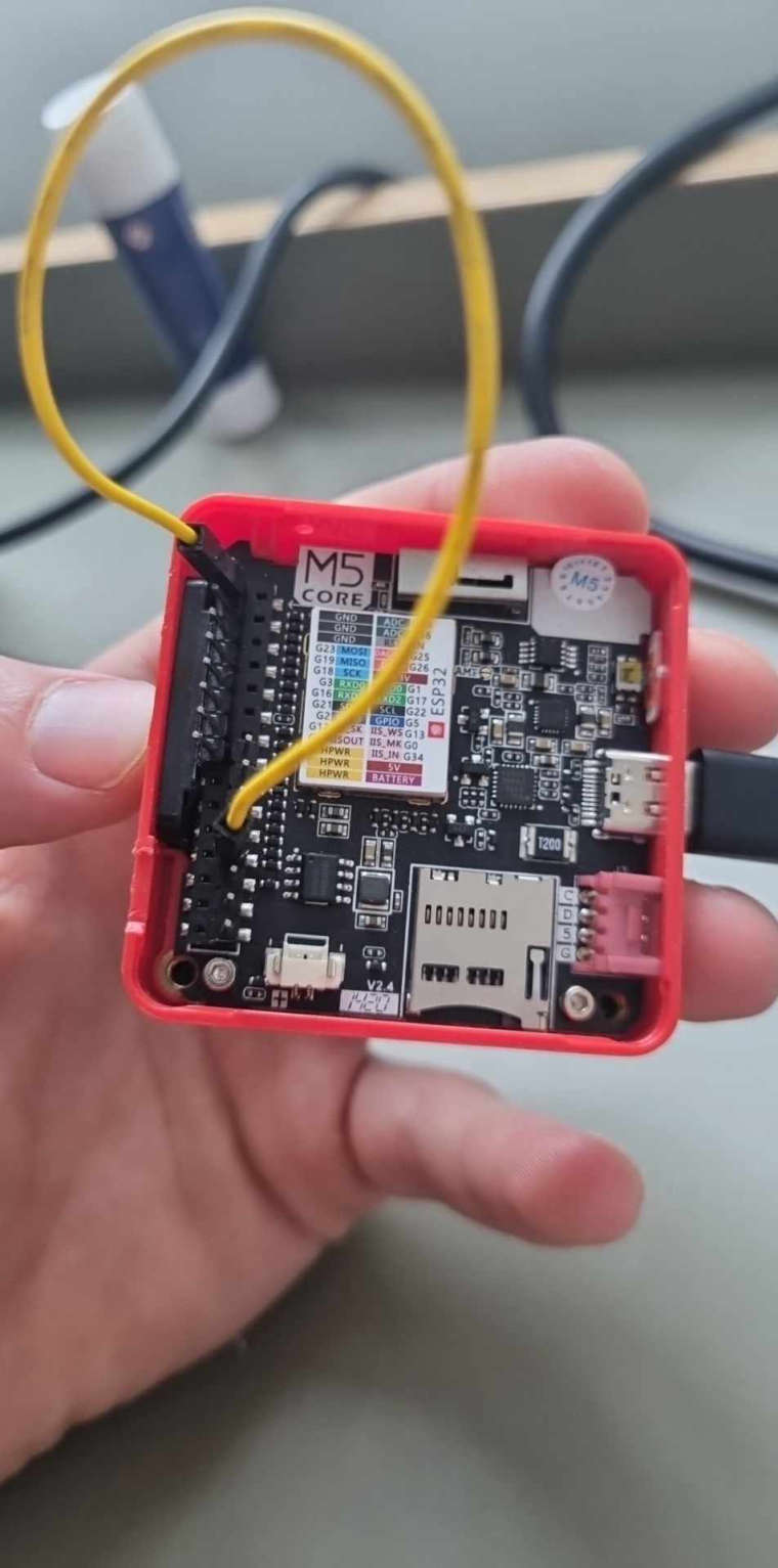

For the M5FIre do this
For the m5stack fire you need to follow these steps- Remove all modules, leaving only the host
- Then try to lower the baud rate when burning
- If there are wires, you can short-circuit G0-GND before powering on the device and then power on again.!

SOLUTION
I found the solution:
You need to follow these steps- Remove all modules, leaving only the host
