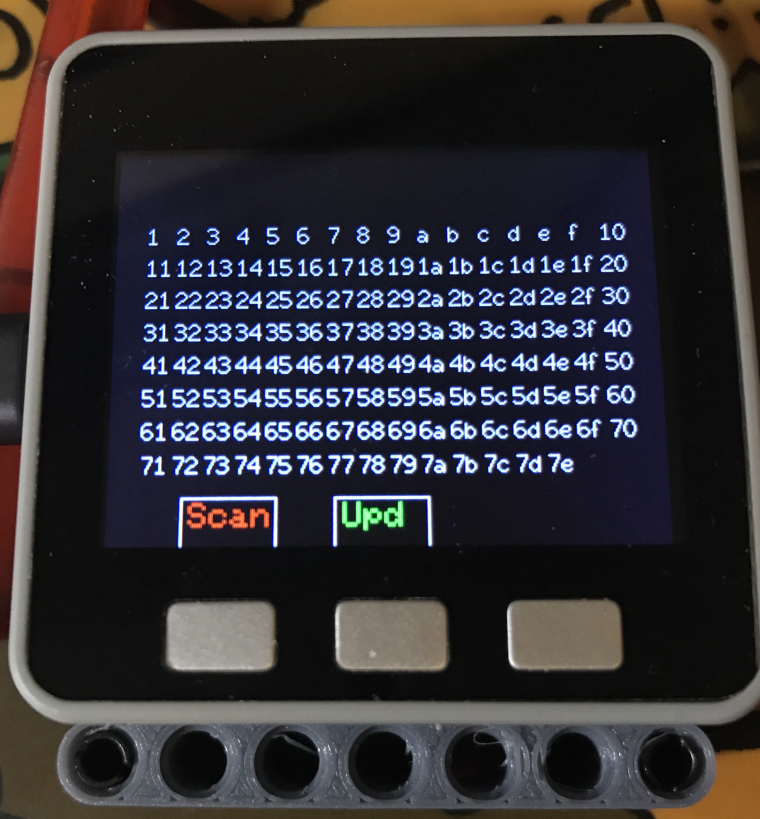

@petero
Have found the issue in the I2C scanner code. I have used Wire.begin(9600); instead of Wire.begin();
The value 9600 is disturbing the whole thing,

Thank you for the answers. Have tried to use some code in the link. Yes, my code is similar.
Then I have isolated the I2C Scanner code and found a very confusing result, all addresses show up as active. Normally I expect to see only the actively used addresses as active.
Here the Scanner code. On M5Stack LCD screen I see all addresses white, see picture.
Is this really normal ?
To check if the cable is broken I will try to connect with the pins and not with the Grove, but could be the unstable connection is in DHT12 module .
