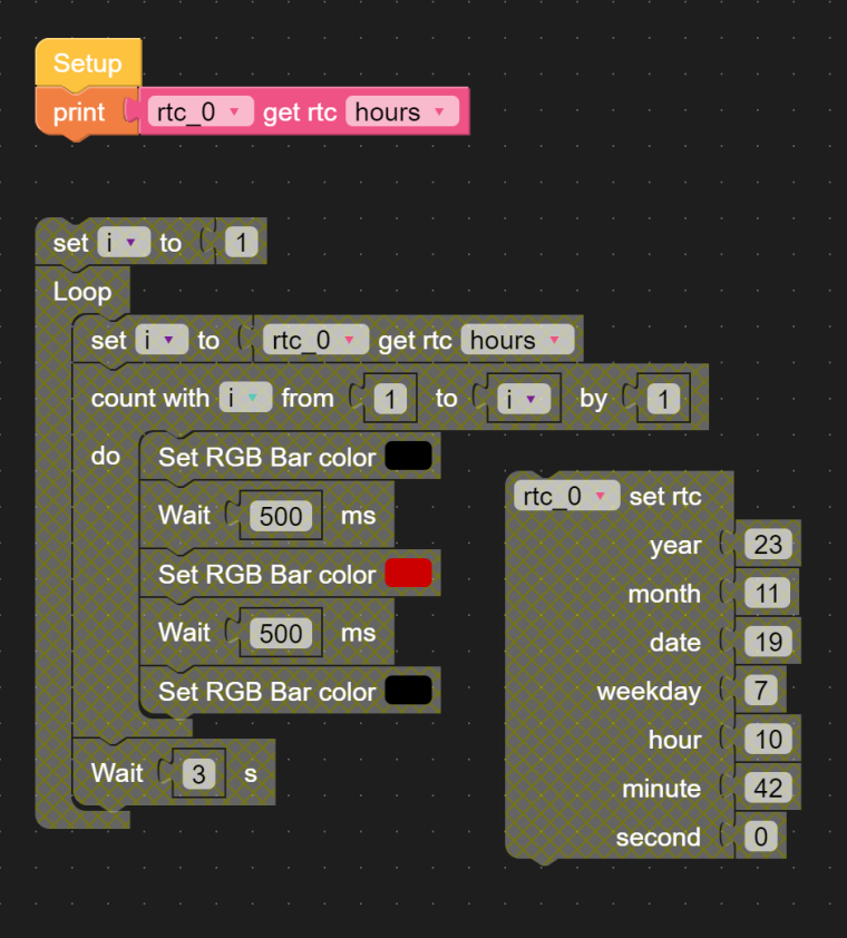

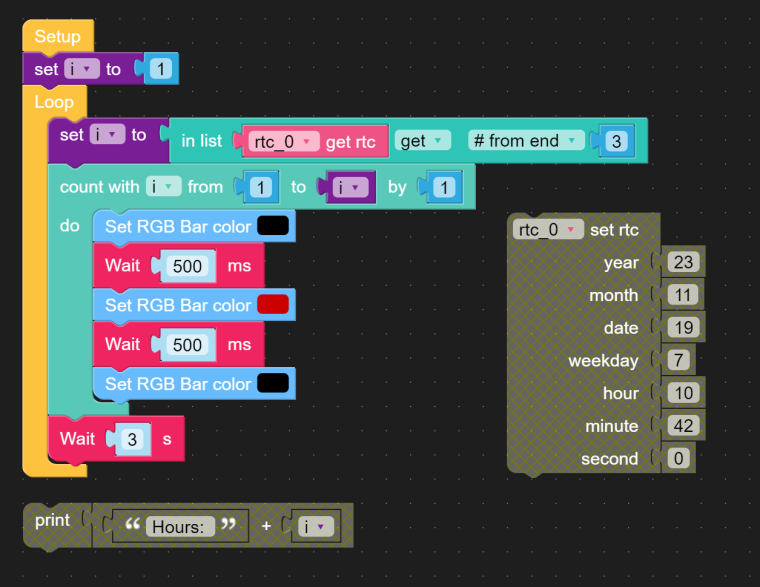

The following runs fine in the desktop IDE V1.9.5 and flashes the LED for the number of months so I know the rtc is set... n.b. not seconds in this example

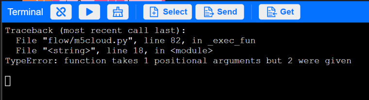

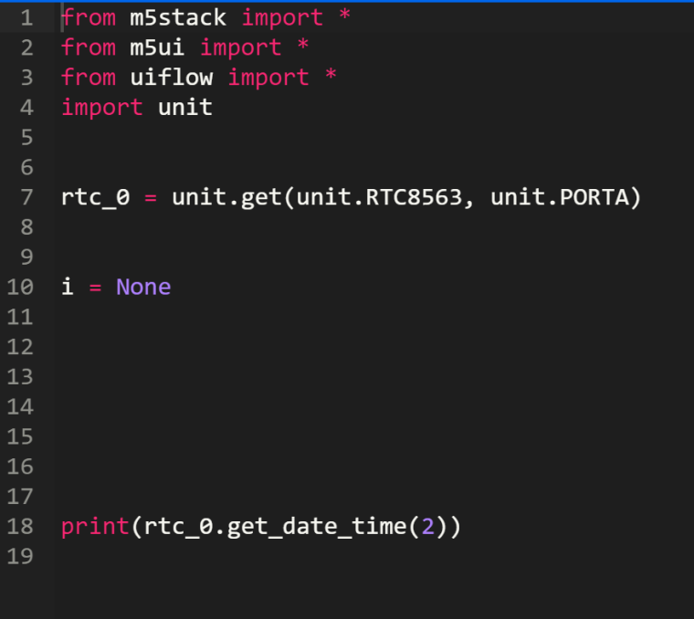

Changing to the Web UIFlow all attemps of running the script with new read statement return an error.
I believe that the the atom and the rtc are working correctly.
The new python code in the Web UIFlow is (rtc_0.get_date_time(2)) where as in the desktop UIFlow it is (rtc_0.get_date_time())[-3] -
UIFlow V1.12.8 Atom Lite RTC read error
Using the block rtc read ["rtc_0" get rtc "seconds'] returns an error
Desktop uiFlow V1.9.5 block rtc [in list] "rtc_0" get rtc [get # from end "0"] returns ok -
