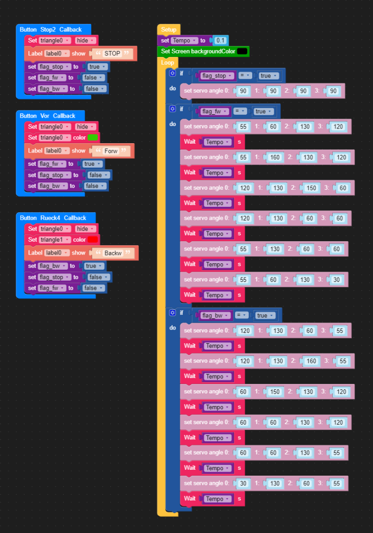

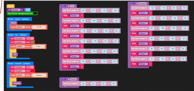

RE: Interrupt routine for remote switch in UIFlow
Thank you. Don't understand what you suggest, but finally I got it working like this:
Maybe you have better idea! -
Putty, the walking robot can go forward or backwards. When walking, I cannot stop or switch direction using a remote switch, because I cannot interrupt the flow. An interrupt routine is needed I guess. I found examples for a H/W pin interrupt, but not for S/W. Can anyone please help me?
