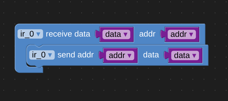

Can anyone write a UIflow program in which the M5 reads and writes the signal from the IR transmitter and then can send it?
Hi @Kris ,
UIFlow support NEC protocol for IR unit, maybe you can try with this:
Recommend download the code to device instead of RUN.
By the way, if you want read the air conditioner or others device single it will more difficult with UIFlow.
