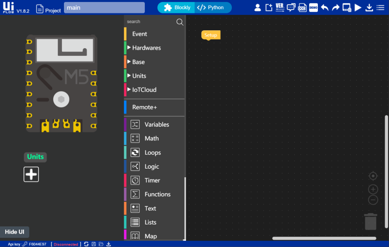

        I would find it nicer if you would take the graphics of the sticker for the M5Stamp Pico

          It not very intuitive having to look in the core section of M5Burner in order to find the stamp firmware.

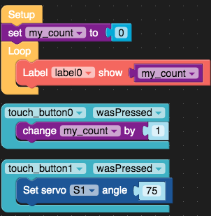

              Hi guys
              Setup: M5Core2 with GoPlus2 module.
              Bug: As soon as I send a servo command, the touch screen stops working until I reset M5Core2.
              In below example I can increase the counter with the first touch button just fine. But as soon as I invoke the servo command with the second touch button the touch screen stops reacting at all.
              Note: the issue only occurs with the first servo (S1).
              Note: the servo command is actually executed and the servo goes to the desired position.
              Note: if the servo command sets angle 0, the touch screen keeps working.
              Please fix. Thank you.
              Thanks
              Felix

                @felmue
                actually, we don't suggest put any complex operation to the callback function. you could try to use this block with if block in the loop.

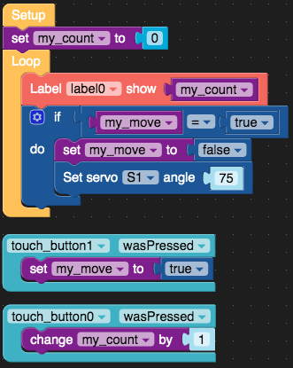

                  Hello @m5stack
                  thank you for your feedback. Unfortunately it did not resolve the issue.
                  I've changed the code to only use a flag my_move in the touch button callback function and then do the real action in the loop.
                  Same result: touch screen becomes unresponsive as soon as the S1 servo command has been executed.
                  Note: it only happens for servo S1. (Same code with servo S2 works fine.)
                  Please test and fix. Thank you.
                  Thanks
                  Felix

                                  ajb2k3
                                  Cant connect M5Stamp to Uiflow. firmware installed but not connecting and no wifi host

                                    @ajb2k3 said in UIFlow 1.8.2:
                                    remove Connection to pin0 and EN
                                    If programator is connected device is in the download mode.
                                    • ajb2k3A Offline
                                      ajb2k3 @OyczE
                                      @mati pins not connected.
                                      going to try reflashing uiflow.
