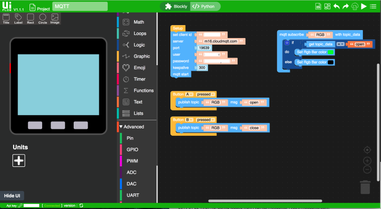

            My flow:

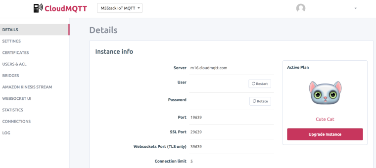

            cloudmqtt settings:
            Here are the logs from cloudmqtt.com. Not sure how to resolve the socket error.

                                    I tried the same blocky today. It uploaded but on the display I only see: error ImportError('mqtt need download...'.)
                                    I am using an M5Stack Fire, firmware 1.1.2.
                                    I have a local MQTT broker running on an Onio Omega and the upload is done with a Windows 10 computer.
                                    Any help would be appreciated.

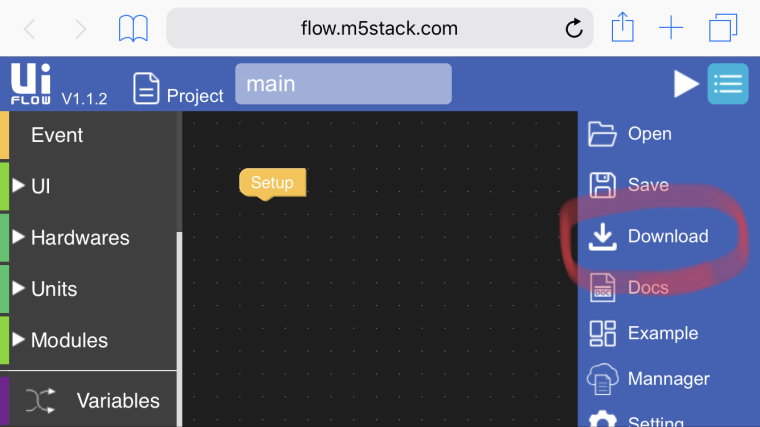

                                      @the_stacker
                                      Instead of running the program directly from uiFlow (which is the triangle button at the top-right), just click the Download option from the hamburger menu.

                                          Just out of curiosity: What's the difference between the two?
                                          Run is just for quick testing of your program. It is erased on a reboot. Download will add the program to the flash storage on the device so you can access it from the APP.LIST menu (middle button when the M5stack is booting up - inbeteeen upload and setup).
