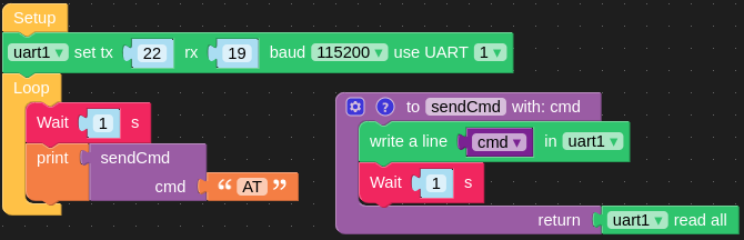

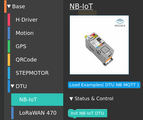

      in UIFlow1 Init NB-IoT DTU block tries a series of AT commands and if one of them is not successful it does not continue and hangs. The AT commands test for proper communication with the modem, then checks that no PIN is set and finally checks if the modem has registered with the provider.
      So lets try to break that down and manually setup the serial connection and try one AT command at the time.
      Below are some UIFlow1 blocks to simply check if the communication with the modem works.
      The result in the terminal should be: b'\r\nOK\r\n' or b'AT\r\r\nOK\r\n'.
      Let me know what you get and we go from there.
      Thanks
      Felix

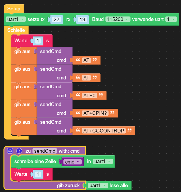

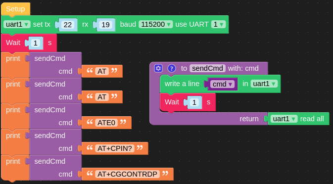

          Now, please try the following commands (which are the same as are used in Init NB-IoT DTU) block, but we can see the responses of the modem:
          You should get something like:
          b'\r\nOK\r\n'
          b'\r\nOK\r\n'
          b'\r\nOK\r\n'
          b'\r\n+CPIN: READY\r\n\r\nOK\r\n'
          b'\r\n+CGCONTRDP: 1,5,"<YourAPN>","10.100.100.100.255.255.255.0"\r\n\r\nOK\r\n'
          Thanks
          Felix
          Examples

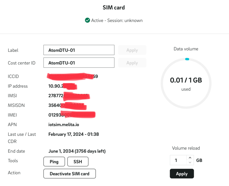

              I just read in the q.beyond FAQ says that the SIM card needs to be activated.
              I assume you did that already?
              Thanks
              Felix
              Examples
              • F Offline
                Felix22
                Yes, I have do it. She is activated.

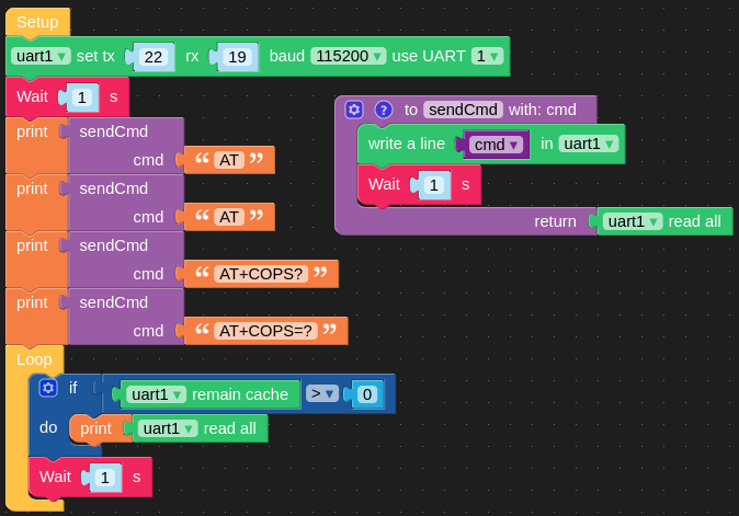

                  ok, let's see what providers your modem can see.
                  Note: the last AT command AT+COPS=? can take a couple of minutes as it has to scan through all bands. (in my case it took about 3 minutes.)
                  Expected output:
                  b'\r\nOK\r\n'
                  b'\r\nOK\r\n'
                  b'\r\n+COPS: 0,2,"22801",9\r\n\r\nOK\r\n'
                  None
                  b'\r\n+COPS: (1,"SWISS GSM","SWISS","22801",9),(1,"sunrise","sunrise","22802",9),,(0-4),(0-2)\r\n\r\nOK\r\n'
                  Thanks
                  Felix
                  Examples

                      Hello @Felix22
                      ok, so it seem that the modem is registered with Swisscom, but doesn't get an IP address since AT+COPS? succeeds, but AT+CGCONTRDP fails.
                      At this point I am not sure what might be the issue. Is there anything in the q.beyond portal, like a log showing some error?
                      Also since you used your iPhone with that SIM card before there might be some kind of security check not accepting a connection from a different device. On the q.beyond portal, is there a way to reset / clear the data from the previous connection?
                      Thanks
                      Felix
                      Examples
                      • F Offline
                        Felix22
                        Interesting, this is the response from the DigitalRepublic-SIM-Card how has no NarrowBand.
                        He see the Network also...
                        Now, ih have deactivated and new activated the SIM.
                        Now its a "3" = "Operator forbidden" (?) (Swisscom)
                        and
                        1 for sunrise
                        • felmueF Online
                          felmue
                          Hello @Felix22
                          hmm, strange. Do you know which roaming partner (Swisscom and/or Sunrise) q.beyond has in Switzerland for NB-IoT? Maybe worth checking with q.beyond support.
                          Thanks
                          Felix
                          Examples

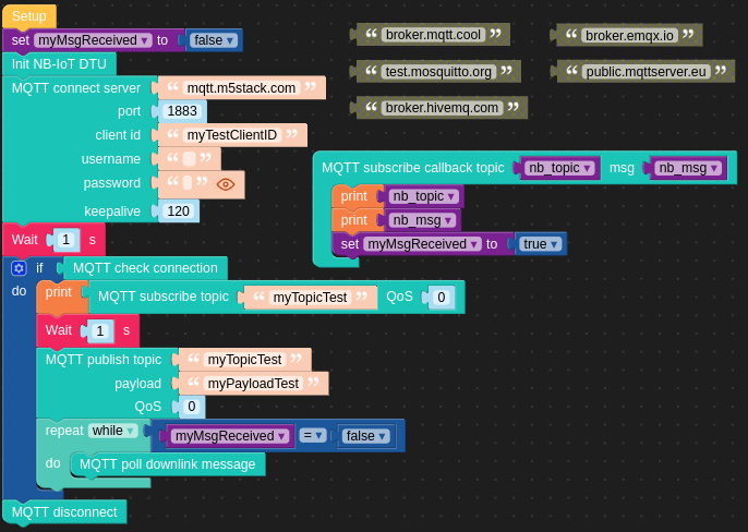

                            If the connection will go on. What are the Code for an MQTT connection ?
                            If i become an IP-Address, can i use the "normal" MQTT Blockly ??
                            Regards,
                            Felix
                            • felmueF Online
                              felmue
                              Hello @Felix22
                              please refer to the SIM7020 documentation for MQTT commands. You can find the PDFs here - section Related Link.
                              As soon as the modem gets an IP address the last AT command AT+CGCONTRDP sent by Init NB-IoT DTU block should succeed and then you can use all the other MQTT blocks.
                              Thanks
                              Felix
                              Examples

                                        Result:
                                        b'\r\nOK\r\n'
                                        b'\r\nOK\r\n'
                                        b'\r\nOK\r\n'
                                        b'\r\nOK\r\n'
                                        b'\r\nOK\r\n\r\n+CPIN: READY\r\n'
                                        b'\r\n+CGREG: 0,5\r\n\r\nOK\r\n'
                                        b'\r\n+CGCONTRDP: 1,5,"iotsim.melita.io","10.xx.xx.xx.255.255.255.0",,"212.xx.xx.xx","212.xx.xx.xx",,,,,1500\r\n\r\nOK\r\n'
                                        Im a big step wider... now, i have become my ip address... :-)
