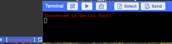

Found it* ...
But, then whát to do to connect?
The Terminal reports connected, the UIFlow screen show [disconnected]
*This Orange Terminal (Beta) button is also displayed when using another browser. -
[Solved] Mac OS UIFlow Desktop-IDE connects, but browser cannot connect to Core2 - Why?
UIFlow-Desktop-IDE connects fine to my Core2 when selecting the correct USB port (driver is OK)
The IDE is missing a lot of units and I don't know yet how to add unlisted Units.The browser version shows [
disconnected] at the left bottom, for both Chrome and Firefox.
API key is OK. The IDE is not running when using the browser.
Where - and how- can I select the USB port to be used to communicate with the Core2? -
