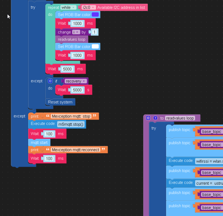

Crashes / exception with atomlite
Hey guys, i have used "try" around my i2c loop and mqtt to get the error and try to recover from it. how ever struggeling to fix it( i heard from an alternative mqtt library but i wanted to know if you guys have another idea)

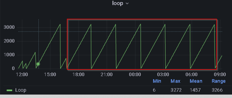

Here you see my grafana graph. Loop gets increased after every "readvalues loop function" (mqtt )
After these about 3000 loops it resets.Here is the flow:
And this( bottom of the read values function) :

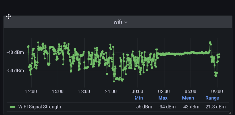

rst:0xc (SW_CPU_RESET),boot:0x13 (SPI_FAST_FLASH_BOOT)i get -104 mqtt exception and -110. i dont get to except it and try to stop the mqtt, wait a sec and start again. The wifi signal is good and its 1 m to the AP on this Atom ( not like in the other thread)

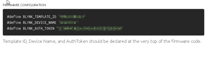

i only used the AUTH_TOKEN, in bylnk cloud there are more things defined, you think this is the problem?

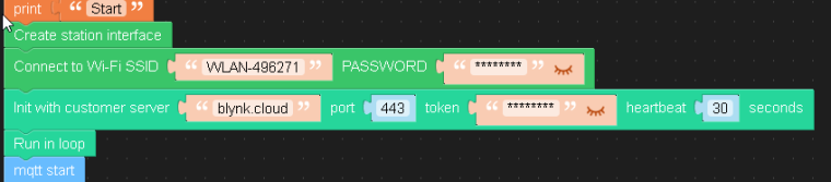

M5stack fails to connect with blynk
Hello guys, i tried to run blynk, but i canot connect my atomlite's to blynk. i tried port 8080, 443 and 80 but the devices doesnt shows up in blynk as Online here is my configuration
print('Start')
wlan = network.WLAN(network.STA_IF)
blynk1 = blynk.Blynk(server='blynk.cloud', port=80, token='XXXX', heartbeat=30)
blynk1.run()
m5mqtt.start()Any ideas?
