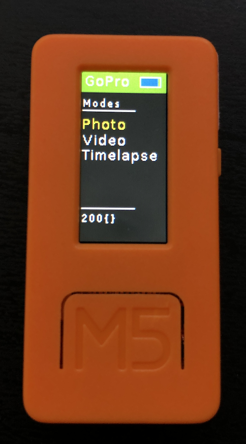

GoPro remote controller
I have created my own wifi GoPro remote controller, that it should work with all the model starting from the GoPro Hero 3+ (some changes may be required). I have tested it with the GoPro Hero 7 Silver but it should also work without any change with the white and black version.
GoPro in the latests version only enable GoPro remote support for the black models, even all of them are capable. As I don't have a black version of the GoPro I created my own controller.
I have used an StickC with the strap and Blockly, but it becoming a mess because of the size of the idea, I would like, some day, port it to Arduino or Python.
Here is the source code and instructions, I really hope you like and contribute!
