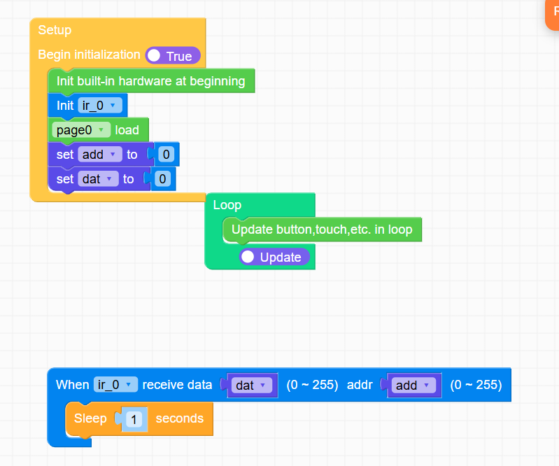

IR Unit with Core S3
I was trying to use the IR Unit with my Core S3 in blocks (UIFlow 2.4.0) and it keeps saying there is an invalid timer time. On Port B, with just the Init block and/or the send block, it works fine. No errors. But when I try to receive data, it just brings back the timer error:
Traceback (most recent call last): File "<stdin>", line 37, in <module> File "<stdin>", line 29, in setup File "unit/ir.py", line 24, in rx_cb File "driver/ir/nec.py", line 116, in __init__ File "driver/ir/nec.py", line 67, in __init__ File "driver/ir/receiver.py", line 47, in __init__ ValueError: invalid Timer number >>>Here is the auto generated code that produced the errors:
import os, sys, io import M5 from M5 import * import m5ui import lvgl as lv from unit import IRUnit import time page0 = None label0 = None label1 = None ir_0 = None add = None dat = None def ir_0_rx_event(_data, _addr, _ctrl): global page0, label0, label1, ir_0, add, dat dat = _data add = _addr time.sleep(1) def setup(): global page0, label0, label1, ir_0, add, dat M5.begin() Widgets.setRotation(1) m5ui.init() page0 = m5ui.M5Page(bg_c=0xffffff) label0 = m5ui.M5Label("label0", x=71, y=65, text_c=0x000000, bg_c=0xffffff, bg_opa=0, font=lv.font_montserrat_14, parent=page0) label1 = m5ui.M5Label("label1", x=69, y=104, text_c=0x000000, bg_c=0xffffff, bg_opa=0, font=lv.font_montserrat_14, parent=page0) ir_0 = IRUnit((8, 9)) ir_0.rx_cb(ir_0_rx_event) page0.screen_load() add = 0 dat = 0 def loop(): global page0, label0, label1, ir_0, add, dat M5.update() if __name__ == '__main__': try: setup() while True: loop() except (Exception, KeyboardInterrupt) as e: try: m5ui.deinit() from utility import print_error_msg print_error_msg(e) except ImportError: print("please update to latest firmware")Here is the block code:
Any help much appreciated! -

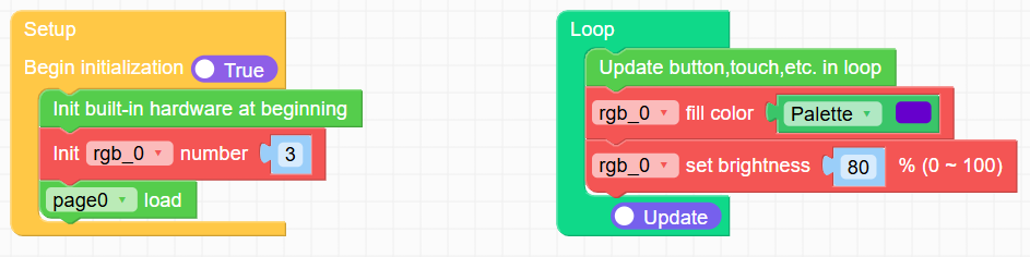

Port A power
I was trying to use a RGB unit with Port A in firmware V2.3.7 for Core 2but the RGB unit just doesn't illuminate. I read in a post created by @Handcannon (https://community.m5stack.com/topic/7829/uiflow2-0-tab5) that Port A is not receiving power in V2.3.7 and V2.3.6 for Tab 5 but V2.3.6 Hotfix worked.
I tried it and it didn't work as I assumed the firmware would have the same handling for Port A. I have now tried Core 2 V2.3.4 to V2.3.7 and none of them work. Any help would be much appreciated!

FelixI tried recreating your M5Tab5 script for the Core 2 and got these results:
(I realise that the RGB Unit doesn't use I2C but for port A to work I think I need to set it up in the same way anyway.)
The code:import os, sys, io import M5 from M5 import * import m5ui import lvgl as lv from unit import RGBUnit from hardware import I2C from hardware import Pin import time page0 = None switch0 = None i2c0 = None rgb_0 = None bytearrayone = None def setup(): global page0, switch0, i2c0, rgb_0, bytearrayone M5.begin() Widgets.setRotation(1) m5ui.init() page0 = m5ui.M5Page(bg_c=0xffffff) switch0 = m5ui.M5Switch(x=130, y=105, w=60, h=30, bg_c=0xe7e3e7, bg_c_checked=0x2196f3, circle_c=0xffffff, parent=page0) page0.screen_load() bytearrayone = bytearray(1) i2c0 = I2C(0, scl=Pin(33), sda=Pin(32), freq=100000) i2c0.readfrom_mem_into(0x43, 0x03, bytearrayone) # set PI4IO P2 (Ext5V enable) as output print(hex(myByteArr[0])) myByteArr[0] |= 0x04 print(hex(myByteArr[0])) i2c0.writeto_mem(0x43, 0x03, bytearrayone) i2c0.readfrom_mem_into(0x43, 0x05, bytearrayone) # set PI4IO P2 (Ext5V enable) to high print(hex(myByteArr[0])) myByteArr[0] |= 0x04 print(hex(myByteArr[0])) i2c0.writeto_mem(0x43, 0x05, bytearrayone) time.sleep(1) rgb_0 = RGBUnit((33, 32), 3) def loop(): global page0, switch0, i2c0, rgb_0, bytearrayone M5.update() rgb_0.set_brightness(100) if switch0.has_state(lv.STATE.CHECKED): rgb_0.set_color(0, 0x6600cc) else: rgb_0.set_color(0, 0x000000) if __name__ == '__main__': try: setup() while True: loop() except (Exception, KeyboardInterrupt) as e: try: m5ui.deinit() from utility import print_error_msg print_error_msg(e) except ImportError: print("please update to latest firmware")1st attempt:
E (725096) i2c: i2c driver install error E (725128) i2c: i2c driver install error E (725275) i2c: i2c driver install error Traceback (most recent call last): File "<stdin>", line 49, in <module> File "<stdin>", line 25, in setup OSError: [Errno 116] ETIMEDOUT2nd attempt:
E (740623) i2c: i2c driver install error E (740655) i2c: i2c driver install error A fatal error occurred. The crash dump printed below may be used to help determine what caused it. If you are not already running the most recent version of MicroPython, consider upgrading. New versions often fix bugs. To learn more about how to debug and/or report this crash visit the wiki page at: https://github.com/micropython/micropython/wiki/ESP32-debugging MPY version : v1.25.0-dirty on 2025-09-30 IDF version : v5.4.2-dirty Machine : M5STACK Core2 with ESP32(SPIRAM) Guru Meditation Error: Core 1 panic'ed (LoadProhibited). Exception was unhandled. Core 1 register dump: PC : 0x40166a09 PS : 0x00060730 A0 : 0x800dc068 A1 : 0x3ffd92f0 A2 : 0x00000000 A3 : 0x3f4329e7 A4 : 0x00000000 A5 : 0x00000000 A6 : 0x00000001 A7 : 0x3ffd92f0 A8 : 0x00000074 A9 : 0x3ffc1090 A10 : 0x00000000 A11 : 0x3ffd94b0 A12 : 0x00000000 A13 : 0x00000001 A14 : 0x00000000 A15 : 0x00000004 SAR : 0x00000020 EXCCAUSE: 0x0000001c EXCVADDR: 0x00000088 LBEG : 0x400945b2 LEND : 0x400945bd LCOUNT : 0x00000000 Backtrace: 0x40166a06:0x3ffd92f0 0x400dc065:0x3ffd9330 0x400f5729:0x3ffd9350 0x400dc46d:0x3ffd9390 0x401ec3f5:0x3ffd93d0 0x401ec4bf:0x3ffd93f0 0x40087c62:0x3ffd9410 0x401e65a8:0x3ffd94b0 0x401ec3f5:0x3ffd9510 0x402161ac:0x3ffd9530 0x402161e9:0x3ffd9570 0x401ec3f5:0x3ffd9590 0x401ec479:0x3ffd95b0 0x402187a4:0x3ffd95e0 0x401ed36c:0x3ffd9660 0x4008739e:0x3ffd9680 0x401e65a8:0x3ffd9720 0x401ec3f5:0x3ffd9770 0x401ec4bf:0x3ffd9790 0x40087c62:0x3ffd97b0 0x401e65a8:0x3ffd9850 0x401ec3f5:0x3ffd9880 0x401ec40e:0x3ffd98a0 0x4021bbf6:0x3ffd98c0 0x4021beda:0x3ffd9950 0x401fde08:0x3ffd9990 ELF file SHA256: 1843f6d45 Rebooting... ets Jul 29 2019 12:21:46 rst:0xc (SW_CPU_RESET),boot:0x13 (SPI_FAST_FLASH_BOOT) configsip: 0, SPIWP:0xee clk_drv:0x00,q_drv:0x00,d_drv:0x00,cs0_drv:0x00,hd_drv:0x00,wp_drv:0x00 mode:DIO, clock div:1 load:0x3fff0030,len:4340 load:0x40078000,len:15972 load:0x40080400,len:4 ho 8 tail 4 room 4 load:0x40080404,len:3656 entry 0x400805c0 _ __ _ _ _(_)/ _| | _____ __ | | | | | |_| |/ _ \ \ /\ / / | |_| | | _| | (_) \ V V / \__,_|_|_| |_|\___/ \_/\_/ V2.3.6-hotfix2 E (2840) i2c: i2c driver install error -
